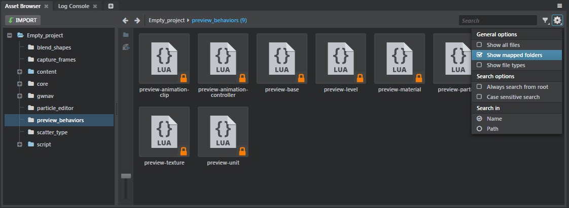

Each folder that you share through a resource extension is treated in the editor as a "mapped folder", similar to the core resources folder. That means:
the Asset Browser does not show the assets by default. The mounted assets will only be shown when the Show mapped folders or Show all files options are active.
the assets in your shared folder are read-only in the editor. In order to modify them, a user would need to duplicate them in the project folder.
