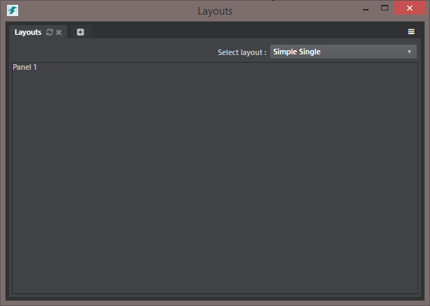

Simple panel used as a container for direct content. Content can be anything.

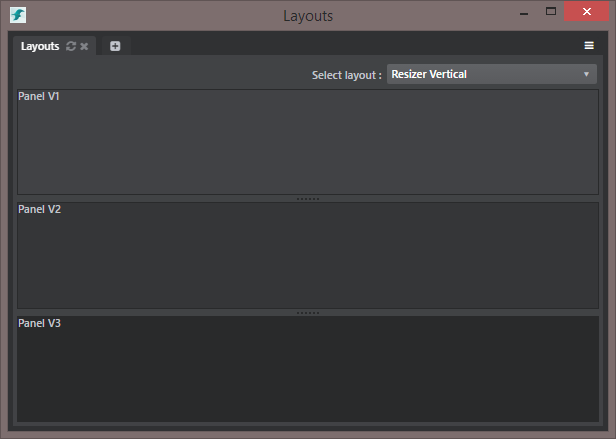

Resizer layouts are similar to Simple Layouts but with the ability to be dynamically resized. Each panels can have a min-size attribute in px which controls the minimum panel size and also a ratio attribute which controls the initial panel size compared to other panels ratios.
In these examples, three panels with each a ratio of 1 will render three panels with exact sizes.

Used to display multiple panel vertically that can be resized individually and each contain their own content panel.
m.resizer.container({direction: 'vertical', redrawOnResize: false}, {className: 'fullscreen'}, [
    m.resizer.panel({'min-size': 50, ratio: 1}, [
        m.layout.container({className: 'stingray-panel stingray-border-dark'}, [
            'Panel V1'
        m.layout.container({className: 'stingray-panel-mid stingray-border-dark'}, [
            'Panel V2'
        m.layout.container({className: 'stingray-panel-dark stingray-border-dark'}, [
            'Panel V3'

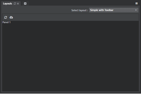

Example of how we can add a toolbar to a simple layout. See Toolbars for reference.
m.layout.vertical({className: 'stingray-panel stingray-border-dark'}, [
    m('div.toolbar', [
        Button.component({
            title: 'Refresh',
            faIcon: 'fa-refresh',
            type: m.button.icon
        Button.component({
            title: 'Refresh',
            faIcon: 'fa-cloud-download',
            type: m.button.icon
    m.layout.container({className: 'stingray-panel-dark panel-fill'}, [
        'Panel 1'

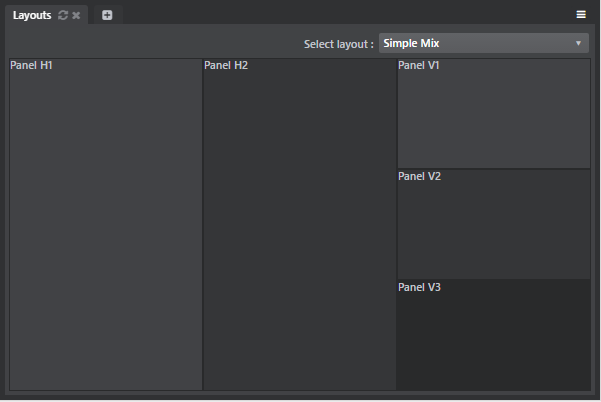

Example of how we can easily mix simple layouts. This is an exact copy of the Vertical Layout placed inside the last panel of the Horizontal Layout.
m.layout.horizontal({}, [
    m.layout.panelFill({}, m.layout.container({className: 'stingray-panel stingray-border-dark'}, [
        'Panel H1'
    m.layout.panelFill({}, m.layout.container({className: 'stingray-panel-mid stingray-border-dark'}, [
        'Panel H2'
    m.layout.panelFill({}, m.layout.container({className: 'stingray-panel-dark'}, [
        /* Vertical Layout : This is an exact copy of the vertical layout */
            m.layout.vertical({}, [
                    'Panel V1'
                    'Panel V2'
                m.layout.panelFill({}, m.layout.container({className: 'stingray-panel-dark stingray-border-dark'}, [
                    'Panel V3'
        /* Vertical Layout : End*/

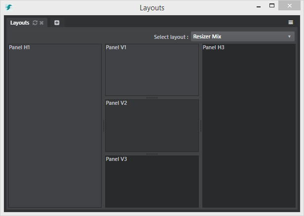

Example of how we can easily mix both types of resizers. This is an exact copy of the Vertical Resizer Layout placed inside the second panel of the Horizontal Resizer Layout.
m.resizer.container({direction: 'horizontal', redrawOnResize: false}, {className: 'fullscreen'}, [
            'Panel H1'
        /* Vertical Resizer Layout : This is an exact copy of the vertical resizer layout */
                        'Panel V1'
                        'Panel V2'
                        'Panel V3'
        /* Vertical Resizer Layout : End*/
            'Panel H3'
