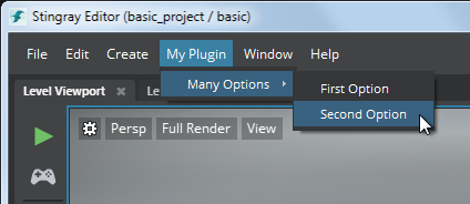

You can create a new menu by using the path parameter without specifying any action or panel to trigger. You can then follow this entry with other menu extensions that populate the menu with new items.
If the path contains no / delimiters, the new item is created in the main menu bar.
For example:
extensions = {
    menus = [
            path = "My Plugin"
            order = 200
            path = "My Plugin/Many Options"
            path = "My Plugin/Many Options/First Option"
            action = "..."
            path = "My Plugin/Many Options/Second Option"
            action = "..."
This configuration produces the following:

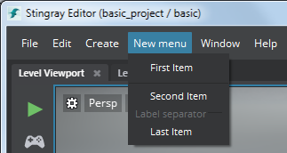

You can create simple menu separators, or separators with a label.
extensions = {
    menus = [
            path = "New menu"
            order = 500
            path = "New menu/First Item"
            action = ...
            path = "New menu/Separator with no name"
            separator = true
            order = 100
            path = "New menu/Second Item"
            order = 200
            action = ...
            path = "New menu/Label separator"
            section = true
            order = 300
            path = "New menu/Last Item"
            action = ...
            order = 400
