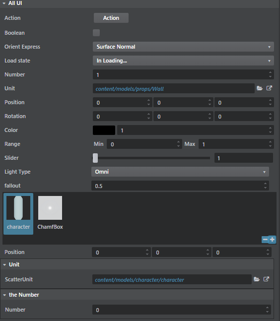

You can use the editor's Property Editor panel to view and modify a wide range of different types of properties -- both simple types like strings, booleans, and numbers, and compound types like colors and rotations. You also have a lot of control over the way the Property Editor displays these values. Many property types can be represented using a variety of UI widgets -- like, a number could be edited using a text field, a slider, a spinner box, etc.; you can control display labels, tooltips, ordering, etc.
To tell the Property Editor how it should visually represent the data it is editing, you can give your data some metadata. There are two main ways to do this:
If your data is described in a type file, you can use an editor block for each type in the data to describe how that type should be represented in the editor. See also The 3ds Max Interactive Type System.
Or, you can use a compact notation that is expressed purely in JavaScript. See Use the Property Editor component in your UI.
This reference details the different kinds of built-in metadata the Property Editor understands, and shows how to use them in both SJSON type files and in JavaScript.

    type = ":number"
    min = 0
    max = 100
    default = 50
    editor = {
        order = 140
        label = "Health"
        suffix = "HP"
        description = "Initial health of the entity"
        control = "adskPropertySlider"
        step = 10
var numberProperty = props.slider("Health", m.prop(50), {
    order: 140,
    suffix: "HP",
    description: "Initial health of the entity",
    min: 0,
    max: 100,
    increment: 10

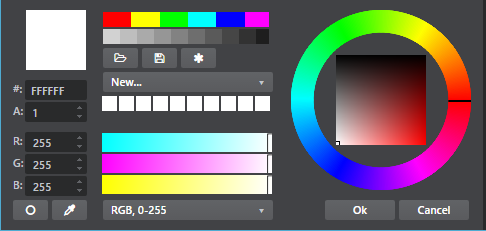

A color swatch with an accompanying intensity slider.
Clicking the swatch brings up a color picker dialog:
Color = {
    type = "core/types/color"
// see core/types/color.type export = "#color" types = { color = { type = ":struct" fields = { rgb = { type = ":array" value = "#component" size = 3 default = [0, 0, 0] } alpha = { type = "#component" default = 1 } intensity = { type = ":number" default = 1 min = 0 } } editor = { control = "adskPropertyColor" } } component = { type = ":number" min = 0 max = 1 } }
// Simple color:
var colorProperty = props.color("Color", genModel([1,1,1]));
// HDR color:
var hdrColorProperty = props.hdrColor("Color", genModel([1,1,1]), genModel(1));

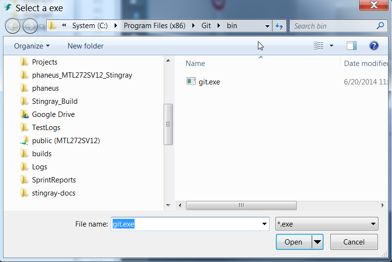

The path property allows a user to select either a folder or a file on disk, using a window provided by the operating system.
| Property | Type | Default | Description |
| browserType | string | Can be either File or Folder. Defines what type of native path selector will be popped. | |
| browseTitle | string | Title of the native dialog. | |
| browseFilter | string | File filter to only show files with a specific extension. |
FilePath = {
    type = ":string"
    editor = {
        control = "PathProperty"
        browseType = "File"
        browseTitle = "Select an exe"
        browseFilter = "*.exe"
DirPath = {
    type = ":string"
    editor = {
        browseType = "Folder"
        browseTitle = "Select a folder"
var fileProperty = props.file("File", genModel('c:/Pogram Files (x86)/Git/bin/git.exe'), "Pick an exec", "*.exe"),
var dirProperty = props.directory("Folder", genModel('c:/Pogram Files (x86)/Git'), "Pick a folder"),

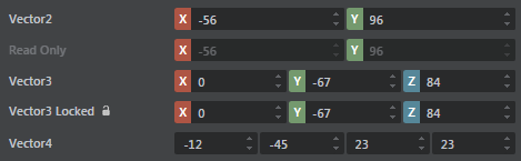

A control that can be used to display a list of 2, 3 or 4 components -- but not a rotation (see Rotation below).
Position = {
    type = "core/types/vector3"
// see core/types/vector3.type
export = "#vector3"
types = {
    vector3 = {
        type = ":array"
        value = ":number"
        size = 3
        default = [0, 0, 0]
        editor = {
            control = "adskPropertyVector3"
var vec2 = props.vector2("Vector2", genModel([34, 78]), {min: -100, max: 100, increment: 0.5});
var vec3 = props.vector3("Vector3", genModel([1,2,3]));
var vec4 = props.vector4("Vector4", genModel([34, 78, 67, -90]));
