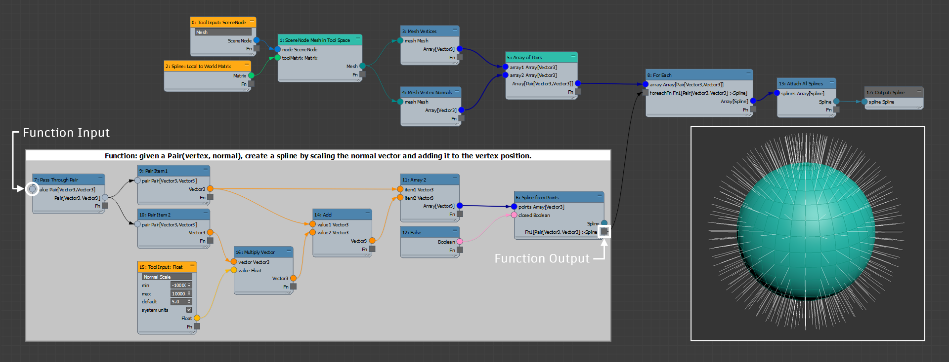

A function is a sub-graph connected by a square function connector.
The inputs of a function are the unconnected inputs contained in the sub-graph.
The output of a function is the square function connector on the last node in the sub-graph.
In the example above, the function's input is the unconnected input of Pass Through Pair. The function's output is the result of Spline from Points. In this graph, a new spline is created for each input, and the resulting array of splines is returned in the For Each node's output.

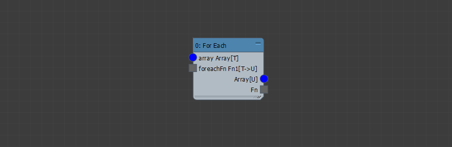

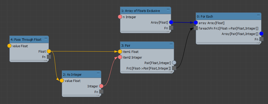

The type Fn1[T->U] can be read by decomposing it into three components: Fn1, T->, U.
Fn1: A shorthand notation which indicates that the function requires one (1) input argument. A function which requires two arguments begins with Fn2, and so on.
T->: The type T to the left of the arrow -> represents the argument type. Single-letter types such as T, U, V, T0, T1, as well as the Any type represent generic types which have not yet been assigned or inferred.

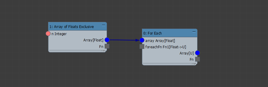

On the For Each node, the generic type T is shared with the input array type Array[T], meaning that the type T of the function's argument must match the type T contained in the array. To see this in action, connect an Array[Float] into the array slot. The type T is now inferred as a Float in the function's type.
U: The type U to the right of the arrow -> represents the function's output type. U is generic, and since it differs from T, there is no constraint between the two types. U may ultimately be the same as T, but this outcome is not enforced.

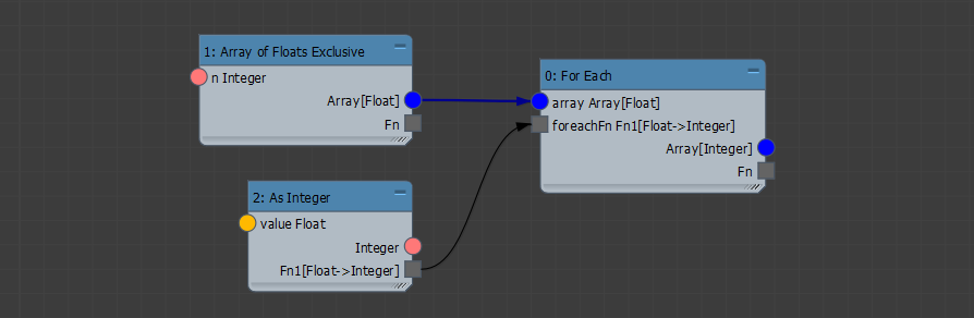

Since U unconstrained, we are free to create a function which converts an input Float into an output Integer. Doing so promotes U to an Integer.

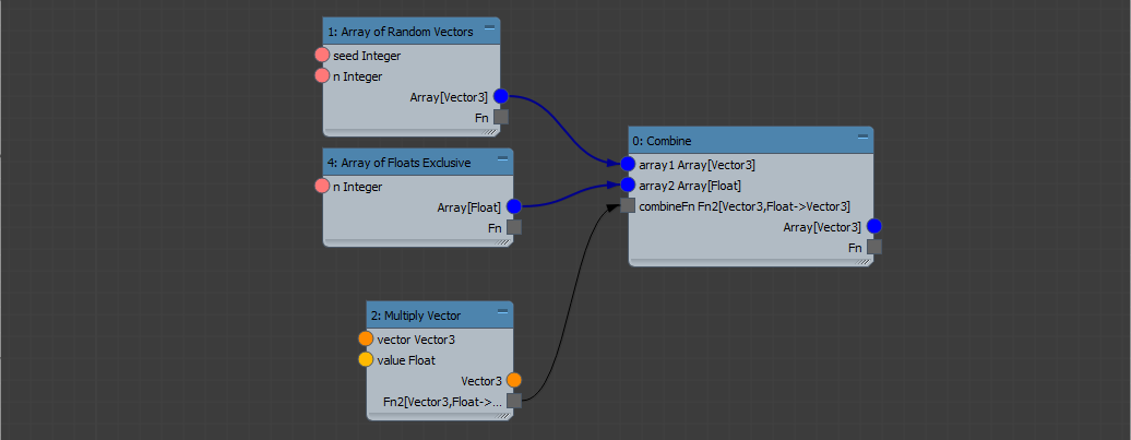

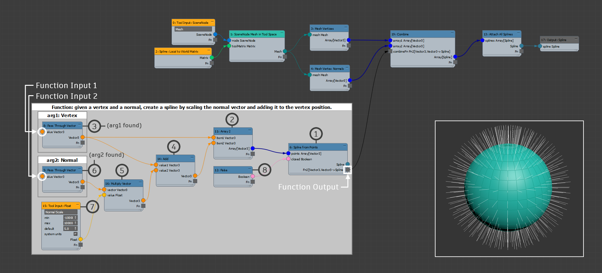

Operators like Combine require functions with more than one input. Multi-input functions are expressed with the shorthand prefix (Fn2, Fn3, Fn4, etc) along with comma-separated types to the left of the arrow symbol (->). In the case of Combine, the function Fn2[T,U->V] requires two generic inputs T, U, and outputs a generic type V.
The types T and U are shared with the input arrays Array[T], Array[U], indicating that the first argument must match the type T contained in array1, while the second argument must match the type U contained in array2.

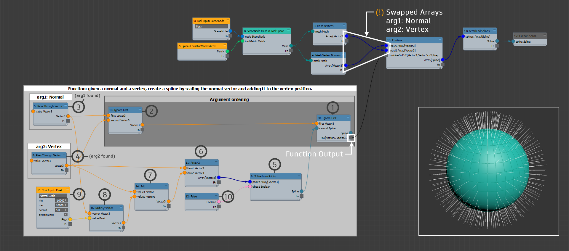

The order of a function's arguments is determined by a depth-first, top-to-bottom traversal from the function's output towards its inputs. The graph below has been labeled with the traversal order. During the traversal, nodes which have already been visited are skipped.

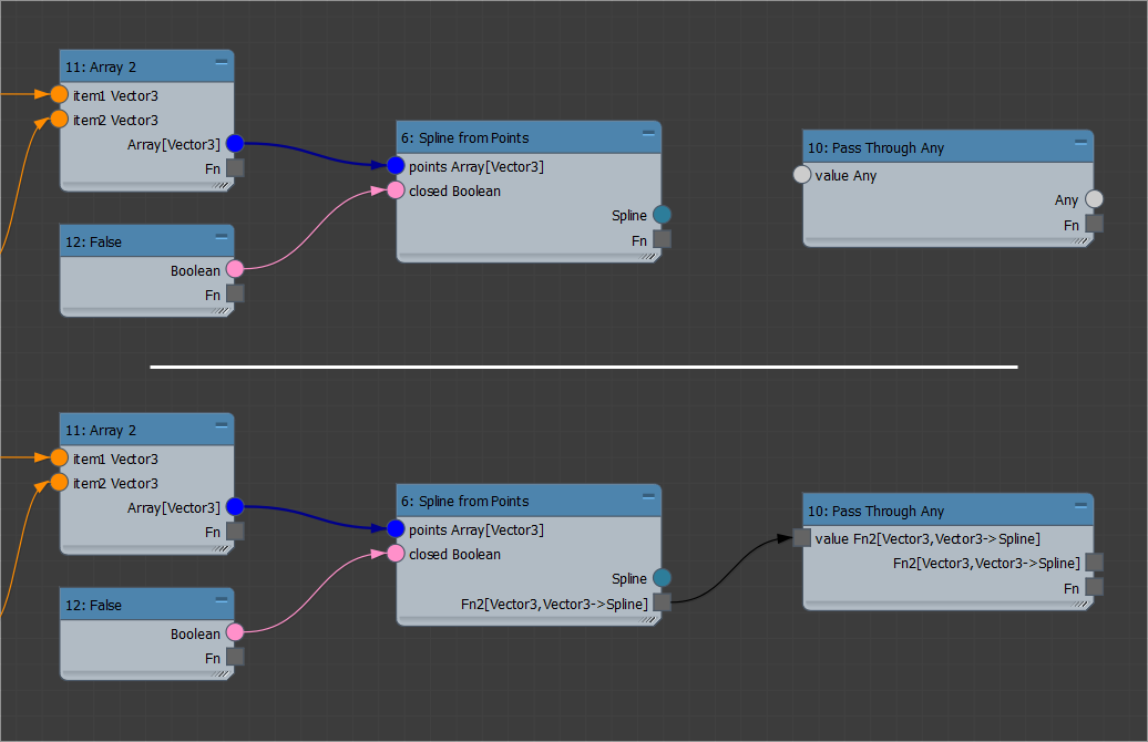

Tip: You can connect a Pass Through Any operator to a function connector to diagnose a function's signature while you build it.
As a (convoluted) exercise, the graph below illustrates how Ignore First can be used to control the node traversal (and therefore the argument ordering) explicitly. Note that Ignore First evaluates its first branch but discards the result, then returns the result of its second branch. Ignore First and Ignore Second can be used to control function argument ordering, or to control the order of execution of operators which have side-effects in 3ds Max (ex: Clone as Instance, Create Editable Mesh, Create Editable Spline, Evaluate MAXScript).
