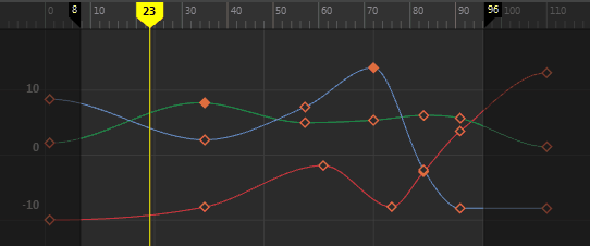

| Resize the Playback range | On the Time Ruler, click the edge of the dark region and drag to change the playback range. Stretch the playback range in the time view by dragging the flags on the Time ruler.
| Scrub animation | Drag the Current Time Marker.

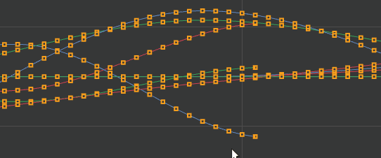

| Move a key | Select a key and drag it.
![]() To open the Move Key tool, select Settings. You can also middle-click an empty area of the Graph Editor and drag to reposition selected keys. ![]() |
| Move multiple keyframes in time without changing the attribute value | Drag-select the keyframes to move. Shift-middle-drag the frames left or right.

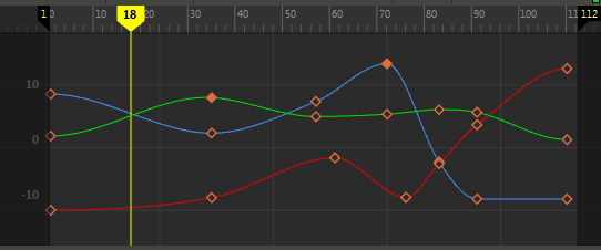

| Change views | Absolute view: Press
1
This view is the default. ![]()

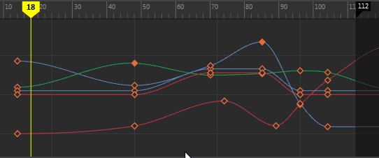

Stacked view: Press
2
Normalized view: press
3
![]() Select to revert back. Note:
Curves are automatically renormalized when you turn on Display Normalized or the active curve list changes. |
