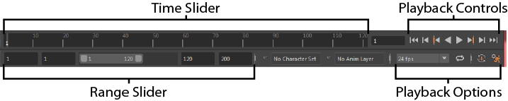

Maya’s controls for developing the timing of animations include the Time Slider, Range Slider, Playback Controls and Playback Options . You can also quickly access and edit animation preferences from the Playback options area.
Between the Range Slider and the Playback Options are the current character control features and the automatic keyframing (Auto Key) button. For details on automatic keyframing, see Use Auto Key.
The Time Slider controls the playback range, keys, and breakdowns within the playback range.
For more information, see Time Slider.
The Playback Controls are buttons for playing and stepping through your animation. The playback range is displayed in the Time Slider.
For more information, see Playback Controls.
The Range Slider controls the playback range reflected in the Time Slider.
For more about how to resize the playback range with the Range Slider, see Range Slider.
A. Framerate menu B. Loop C. Auto Key D. Animation Preferences
For more information, see Playback Options.
