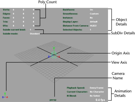

menu.Turns on or off the display of a list of animation details, which include: Playback Speed, Current Character, and IK Blend. The details are displayed above the Frame Rate in the bottom-right corner of the panel. The default is off.
Displays the camera name (such as persp, top, side, front) in the bottom-center of the view panel. The default is on.
Displays an in-view message when Caps Lock is on. The default is on.
Displays the current playback frame number in the bottom-right corner. The default is off.

Displays the focal length of the current camera in the bottom-right corner. The default is off.
Displays the frame rate in frames per second (FPS) for the current view in the bottom-right corner. The default is off.
Displays the current HumanIK Keying Mode for your scene in the bottom-right corner. The default is off.

Displays a list of object details that includes: Backfaces, Smoothness, Instance, Display Layer, Distance From Camera and number of Selected Objects. The details are displayed in the top-right corner of the panel. The default is off.
Displays the global axis at the origin (0, 0, 0) within the perspective view. The default is off.
Displays the total number of particles and the number of selected nParticles in the scene. Particle Count includes the number of nParticles and classic particles in the scene.

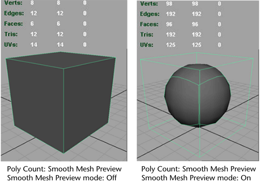

Displays polygon statistics for the visible objects displayed in the view panel, including Vertices, Edges, Faces, Triangles, and UVs. This feature is useful for games development. The first column on the left lists the total components of all the polygons in the scene. The second column lists the total components of the selected polygon(s). The third column lists the total selected components. The default is off.
In Viewport 2.0, the Poly Count includes all objects in the scene, including those that are off screen. On the other hand, the Poly Count displayed in the Legacy Default Viewport only includes the objects seen by the camera.
Poly Count >
has two options.
Displays the polygon statistics of the cages (the original meshes) for the visible objects in the panel.
Displays the polygon statistics for the visible objects displayed in the panel.
When the display is set to default mode, the cage statistics are shown.
When the display is set to Smooth Mesh Preview mode, the statistics for the smoothed objects are shown.
Displays the scene timecode in the bottom-right corner of the scene view. Default is off. See also Set and display timecode for the scene.
Displays the current state of Soft Selection in the bottom-right corner of the scene view.
Displays the current axis of symmetry in the top-middle of the scene view if Symmetry is active. The default is on.
Displays the global axis in the bottom-left corner of all views. The default is on.
Displays the viewport type and rendering engine in the top-center of the viewport. The default is off.
