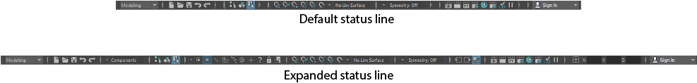

The Status line lets you:
to expand hidden sections.
