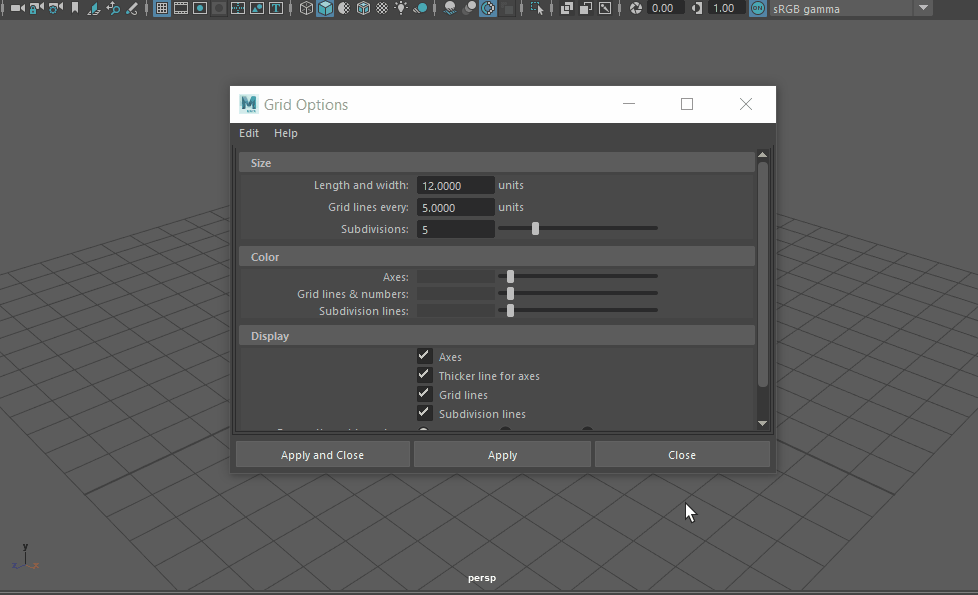

Grid Options
Use these options to customize the Maya Grid. See also Show, hide, or change the grid.
Size
You can change the size and length of the grid, set the number of subdivision lines, and the increment for the grid lines.
Length and width
Sets the number of units for the length and width of the grid. This setting defines the overall size of the grid in the Maya viewport. The default is 12 units.
The grid behind the Grid Options window resizes when the setting is changed
Grid lines every
Displays a grid line every n units. This setting defines the size of each square inside the grid. The default is 5.
The squares in the grid behind the Grid Options window resizes when the setting is changed
Subdivisions
Specifies the number of divisions in each grid square. Setting the Subdivisions option to more than 1 specifies that each main grid square is divided by the amount specified. The default is 5.
The squares in the grid behind the Grid Options window are divided when the setting is changed
