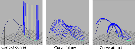

You can modify the behavior of
		Paint Effects tubes using a system of
		control curves, which are CV or EP curves associated with strokes. You can set stroke tubes to follow control curves and to be attracted to them.
If you are animating your scenes, you can use control curves to make tubes react to movement. When you keyframe the movement of the control curves, the stroke tubes react to that movement according to the tube settings for the stroke.
If you create many control curves, spaced close together, the stroke tubes will curl over roughly parallel to each other; if there are few control curves, the stroke tubes will lean forward and back along the stroke in response to the attractive force from the control curves.
