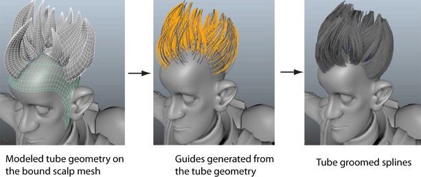

Use tube-shaped polygon meshes to define the shape of a default spline hair groom. XGen generates guides from the shape of the modeled tube objects.
You can then preview the default splines for the groom and then hide the tube objects. To use polygon tube objects, ensure they are closed at both ends and have no interior boundary edges.

The guides generated by the tube geometry display in the scene. Preview the Description to see the splines.
XGen also creates a region map based on the footprint of the tubes (guides generated from the tubes).
