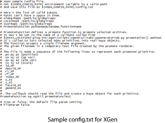

By default, XGen uses the XGEN_CONFIG_PATH environment variable for configuring file locations. It must point to a directory containing a config.txt properties file. The following image is an example config.txt:
To set the Global or Local file repositories to a custom location, you must create a directory structure that is the same as the default xgen directory. For example, create an xgen directory with expressions, archives, and fxmodules sub-directories in the custom location. The XGEN_CONFIG_PATH environment variable must point to the custom location.
