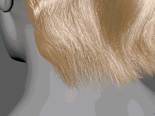

Sets the resulting hair length after the cut effect is applied by the brush stroke.

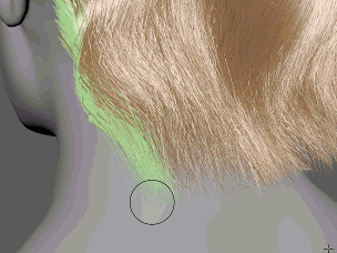

Controls the strength of the color overlay of the Preselection Highlight.
When on, hairs affected by the brush are highlighted before you begin grooming. Click the Color swatch or use the slider control to change the highlight color. This option is on by default
