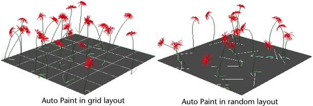

You can quickly fill a surface with strokes without painting them individually or copying and pasting them. There are two ways you can do this:
To automatically paint multiple strokes on a surface in a grid layout
- Select the brush you want to paint with.
- Select the NURBS or polygonal surface you want to paint strokes on automatically.
- Select
		  . For information, see
		  Paint Grid Options.
- Set the appropriate options and then click
		  Paint Strokes.
To automatically paint multiple strokes randomly on a surface
- Select
		  Paint Random Options.
		  Paint Strokes.
