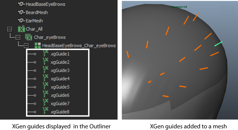

to place guides on faces of polygon surfaces. You can place any number of guides on each face and any area of a polygon mesh, including curved and sloping areas. By default, guides display as orange flat curves in the scene view. See Shape spline primitives using XGen guides
In the Outliner, each guide is represented by this icon
and a unique ID.
After adding guides to a mesh surface, typical workflows include shaping the guides by manipulating their CVs. When you preview the Description, the generated primitives are influenced by the guide shape.
