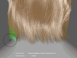

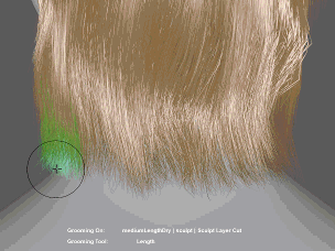

Selection Mode: Floating
Selection Mode: Locked
