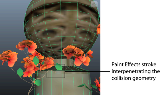

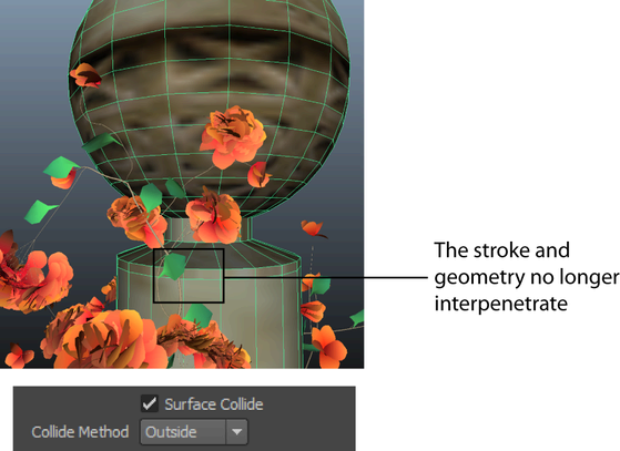

- If some strokes interpenetrate the geometry, and you want to prevent this, turn on
				Surface Collide.
- Set
				Collide Method to specify whether the stroke should collide with the
				Outside,
				Inside, or
				Both Sides of the object surface.

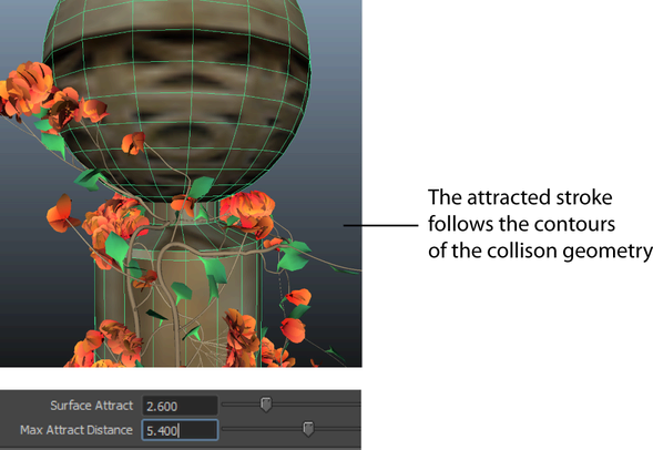

- Increase
				Surface Attract to apply a force that pulls tube end points back toward the geometry surface.
- Set
				Max Attract Distance to specify the area affected by the attractive force.
