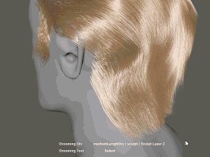

			 - Screen
- Selects all the hairs in the brush radius based a 2D projection of screen space. Use this option for general selection tasks.
					  Selection Type: Screen

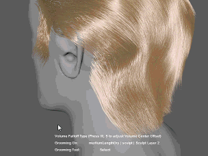

- Volume
- Selects hairs based on a 3D spherical selection area that is positioned at the center of the brush radius. Use this option when you need to minimize the selection area and make precise selections.
					 Adjust the
						 Volume Search Radius and
						Volume Center Offset attributes to control the size and placement of the selection area.
					   Selection Type: Volume
