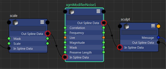

After you add a modifier, you can edit, delete, or disable it in the Node Editor like other Maya nodes.
All interactive grooming modifier nodes start with xgmModifier followed by its name, for example, xgmModifierNoise for the Noise modifier. For a list of modifiers and their node names, see Interactive grooming modifiers.
The modifier node appears in the Interactive Groom Editor using its node name.
