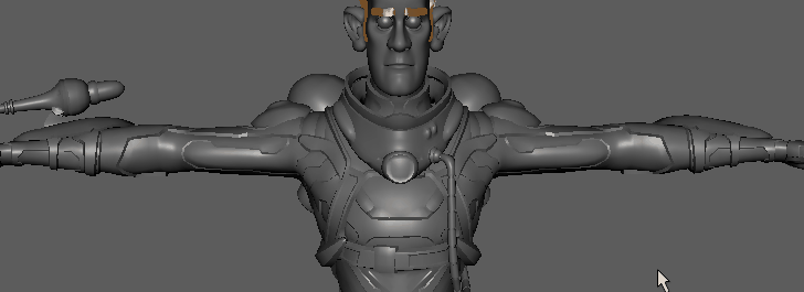

You can assign a visibility setting to animation controllers so that they appear only when your mouse passes near them. This can be useful for decluttering the viewport when you work with scenes that have many sets of controllers.
To set controller visibility
- You must have a rig with controllers set. To set controllers on a rig, see
Tag objects as controllers.
- Locate the <controller>_tag attribute in the
Attribute Editor.
- Select
Show on Mouse Proximity in the
Visibility Mode menu to assign distance-based visibility to the controller.
