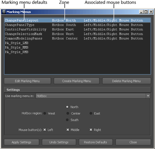

To open the Marking Menu Editor, select Windows > Settings/Preferences > Marking Menu Editor.
Use this editor to edit the available marking menus. Once you define a marking menu, you must assign it to a hotkey or add it to the hotbox before you can use it.
In this dialog box, you can set the menu name and test your marking menu. To edit items within a marking menu, right-click on a marking menu icon and select Edit Menu Item.
This editor appears when you edit a marking menu item.
Enter the name of the marking menu item.
Enter the name of the icon file.
Enter the MEL script used as the command for the menu item. You can middle-drag the MEL script from the bottom panel of the Script Editor.
Displays a check box beside the marking menu item.
Displays a radio button beside the marking menu item.
Displays nothing beside the marking menu item.
Turn Option Box on to display the option box
beside the menu item so you can change a tool’s options from the marking menu.
Enter the MEL script to use as the command for the menu item’s option box.
Specify whether the marking menu is linked to the Hotbox or a hotkey.
If you selected Hotbox for Use Marking Menu in, select the Hotbox zone the marking menu occupies: North, South, East, West, or Center.
Select the left, middle, or right mouse button used to display the marking menu. You can select one, two, or three mouse buttons.
If you want to assign the marking menu to a hotkey, you will configure the hotkey in the Hotkey Editor. To open the Hotkey Editor, select Windows > Settings/Preferences > Hotkey Editor.
