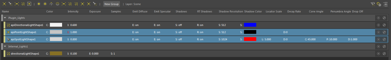

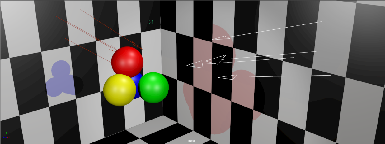

The following example illustrates a scene in which three types of plug-in light nodes have been created. Each light is listed with a different set of attributes, and with custom icons. Two of the plug-in lights are selected, as shown in the viewport.
The Light Editor displays columns for all attributes listed in the various templates. However, the attribute can only be modified for a light if that attribute exists in the xml template file for the specific light type. In this example, Emit Diffuse is a column in the Light Editor because it is in the LEapiDirectionalLightShapeTemplate.mel template file. Meanwhile, because Emit Diffuse is not in the LEdirectionalLightTemplate.mel template file, this attribute cannot be edited for native directional lights via the Light Editor.
