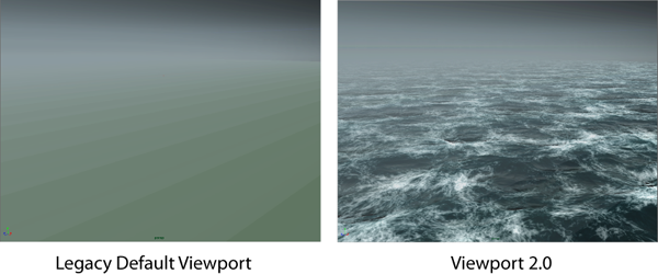

Viewport 2.0 replaces the legacy viewports (default and high quality), and provides improved performance, letting you view high-quality lighting and shadows, materials, and other effects directly within the Maya viewport, without the need to render.
In the following image, you can see difference between the old and new viewports when an
Ocean Shader is applied to a plane.
