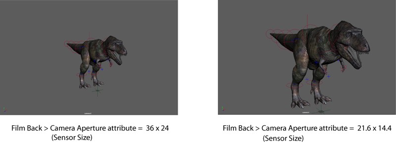

The Film Back > Camera Aperture attribute refers to the portion of the film back that is being exposed. Set this attribute to the sensor size of your camera. You can enter this value in inches or millimeters. The smaller the value, the smaller the angle of view that is captured by the sensor, and thus the closer objects appear without having any perspective exaggeration. The following images illustrate the difference between a sensor size of 36 x 24 versus 21.6 x 14.4 (40% smaller).

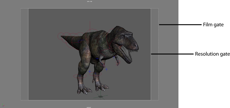

To display the resolution gate and film gate, enable these options from the View > Camera Settings panel menu or from the Display Options of the camera Attribute Editor.
The resolution gate represents the rendering resolution (the region to be rendered). The film gate represents the dimensions of the camera aperture. In this example, the resolution gate is set to an aspect ratio of 4:3 while the film gate is set to an aspect ratio of 16:9. This image demonstrates that the resolution gate can crop the film gate. Display these view guides to ensure that your objects are zoomed or framed as you want in the render output, and that no objects are cropped out of the final rendered image. See Display film gate, resolution gate, and other view guides.
