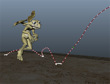

    Depending on the display options you have set, the motion trail displays alongside your animated object. By default, the motion trail displays white markers to represent keys along a red motion trail.
    Note: The motion trail displays keys for the object’s Translate X, Translate Y and Translate Z curves only.
