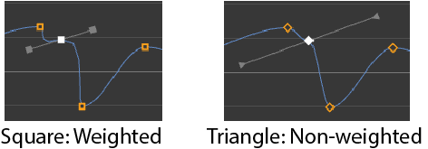

To set the tangent’s weight
Tangent weights dictate the amount of influence a tangent has over a curve segment. See
Non-Weighted and Weighted Tangents.

- In the menu bar, select
Non-weighted tangents have short tangent handles that only control the angle of the tangent.
- In menu bar, select
Weighted tangents have long tangent handles that control the angle and weight of the tangent. Weighted tangents provide finer control over your animation curves.
