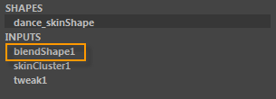

Deformation order
Specifies the placement of the blendShape node in the base object’s history. For most cases, you can select Automatic (the default) and let Maya figure out where to put the blendShape node. You shouldn't need to change the order unless you are performing a specific task and know where you need the blendShape node to be in the object's history.
Automatic (formerly called Default)
The default recommended setting. Maya determines where the blendShape node should be located in the object's history based on the deformers that are currently connected on the selected object. The blendShape node will be placed using either the Pre-deformation or Post-deformation options:
  • The blendShape node uses the Pre-deformation option if the selected object has no deformers, or it has a Skin, Cluster, or Blend Shape deformer in its history. These types of deformers are supported by the Shape Inverter.
  • The blendShape node uses the Post-deformation option if the object has any nonlinear deformers (Bend, Flare, Sine, Squash, Twist, Wave) or any of the following deformers in its history: Lattice, Wrap, ShrinkWrap, Soft Modification, Sculpt, Texture, and Point on Curve. These types of deformers are not supported by the Shape Inverter.
The Shape Inverter essentially allows blend shapes to be added before skinning by inverting the shapes so that they produce the proper results after the skinning deforms the mesh.
Pre-deformation (formerly called Front of chain)
Maya positions the BlendShape node so that it's evaluated before all the deformers (including Skin nodes) in the selected object’s shape history, but after any of the Tweak nodes. Tweak nodes keep track of the translation of the points on the base object as it's deformed - see Point tweaking on objects.
Blend shape deformers are often used to create deformation effects on a skinned character, so Pre-deformation assures that the effects from blend shape deformation occur before those caused by the skin. For more information on doing this, see Create pre-skinning corrective shapes.
You shouldn't use the Pre-deformation option if there are nonlinear deformers (Bend, Flare, Sine, Squash, Twist, Wave) or any of the following deformers in the object's history: Lattice, Wrap, ShrinkWrap, Soft Modification, Sculpt, Texture, and Point on Curve. This is because the effects of these deformers are not supported by the Shape Inverter, so the results from the Blend Shape deformer won't be correct when they're evaluated after Blend Shape.
However, if you need to use the Pre-deformation option in this case, the best solution is to turn off all unsupported deformers, either by selecting the Has No Effect option for the deformer node's Node Behavior > Node State attribute, or by setting the deformer's Envelope attribute value to 0 (no influence).
Post-deformation (formerly called Before)
Maya positions the blendShape node so that it's evaluated after all the other deformers on the selected object. In the object’s history, the BlendShape node will be placed above all other deformers, directly below the object's Shape node.
Post-deformation shapes are mainly used for sculpting corrective shapes on skinned characters - see Create post-skinning corrective shapes for information. These target shapes must be either Tangent Space or Transform Space type (see Add Blend Shape Target Options).
The Post-deformation order ensures that the corrective shape is evaluated after the effect of the skin deformation has been calculated, so the deltas are smaller and the deformation is generally smoother than with Pre-deformation shapes.
