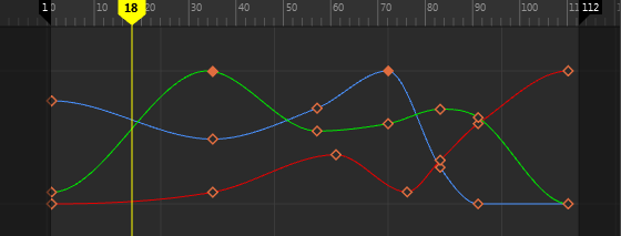

Display normalized curves
To normalize your animation curves
  1. Select the animated objects whose curves you want to normalize.
  2. Open the Graph Editor.
    The Graph Editor appears with all the animation curves for the selected objects displayed in the graph view.
  3. Do one of the following:
    • In the Graph Editor menu bar, select View > Display Normalized.
    • In the Graph Editor tool bar, click the Enable Normalized Curve Display icon ().
    All the curves currently displayed in the Graph Editor’s graph view are scaled to fit within a range of -1 to 1. Only the displayed curves are scaled, not the underlying animation.

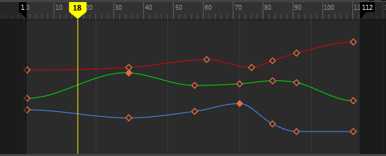

Display stacked curves
By default, curves are displayed overlapping in the graph view. You can switch to view a stack of individual curves.
To view a stacked display of curves
    From the Graph Editor menu bar, select View > Stacked View. See also Stacked Curves for more information.
    Tip:
    Customize the individual curve colors of the Graph Editor in the Color Settings.) You can also modify the horizontal lane width in the Stacked view spacing setting in the Animation (Setting) preferences.
    Attention:
    When using the Scale Keys Tool or the Lattice Deformer Keys Tool with Stacked Curves turned on, you can only modify the time value.
To turn off stacked display of curves
  1. From the Graph Editor menu bar, select View > Stacked View again.
Tip:
You can also toggle Stacked curves on and off quickly using the Enable Stacked View and Disable Stacked View icons in the Graph Editor toolbar.
