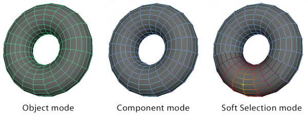

  1. Ensure that Maya LT is in Object selection mode (press F8) - see Selection modes.
  2. Pick the Select Tool from the Tool Box and click an object; or, either Shift-click or Shift + Ctrl-click to select multiple objects. Shift-click toggles on and off the last selection, while Shift + Ctrl-click always adds to the selection.
    To remove an object from the selection, Ctrl-click.

  1. Ensure that Maya LT is in Component selection mode (press F8) - see Selection modes.
  2. Right-click an object and select a component type from the pop-up menu that appears. (For example, select Edge to select only edges, or Vertex to select only vertices.) See also Select specific component types.
Tip: You can also select components in Soft Selection mode (press B). This is useful for sculpting smooth objects or smoothly adding integrated slopes or contours to your geometry without having to transform each vertex manually.
