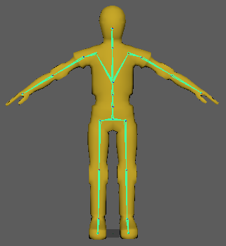

Character in its bind pose
If you bound skin to selected joints only, returning to the bind pose resets all the joints of the skeleton to the bind pose. Also note that the skeleton will go to the bind pose even if it is parented to group nodes.
