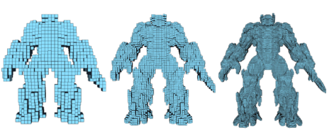

Voxels
Voxel is a term used in 3D to describe the amount of capacity or space a 3D object occupies. Voxels are useful for representing regularly-sampled spaces that are dissimilarly filled.
Voxelization is the act of converting a 3D geometric object into a set of voxels that closely approximates the input mesh. This process is similar to the rasterization process in 2D.
This example shows a character mesh voxelized at different resolutions.
