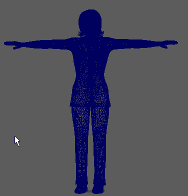

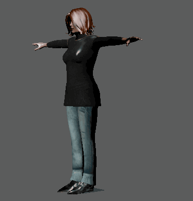

  1. Start with an empty character mesh.
  2. Select Skeleton > Quick Rig from the Rigging menu set. The Quick Rig tool opens. (You can also access Quick Rig from the HumanIK window Start pane or the Rigging shelf.)
  3. Choose the One-Click option.
  4. Select the mesh.
  5. Click Auto-Rig!. A skeleton is created, followed by a HumanIK control rig. The mesh is then skinned to the skeleton.
  6. Your mesh now is ready for animating.

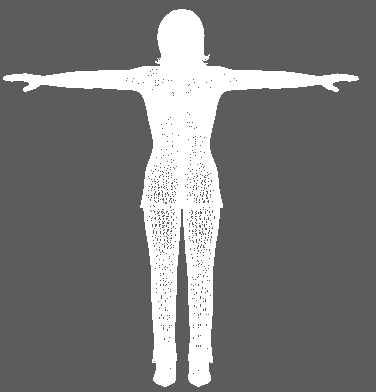

  3. Expand 1) Geometry to choose the mesh(es) for rigging and click Select All Meshes to locate all meshes in the scene.
    Note: Some meshes have auxiliary meshes that accompany them, for example, eyes, hair, accessories, and so on. Use the Select All Meshes option to make sure that these are selected as well.
  4. Select Add Selected Meshes to populate the Geometry list with the selected meshes.

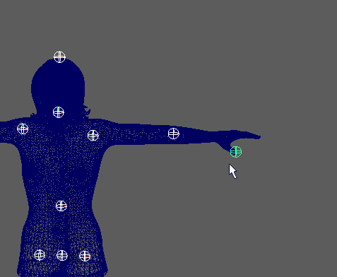

  9. Click Create/Update to add guides to your character mesh. (Click Delete Guides if you want to start over.) If you have trouble seeing guides, change their with the Guide Color option.
  10. Expand 3) User Adjustment of Guides and reposition the joint guides to better fit your mesh. (See Quick Rig tool for a description of each guide adjustment icon.)
    Note: Guides are placeholders that show the future position of each HIK joint; they are temporary transforms, and are not part of the skeleton.
