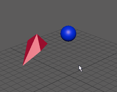

To create an aim constraint
  1. Select one or more target objects, followed by the object you want to constrain to them.
  2. Select Constrain > Aim in the Rigging or Animation menu set.
