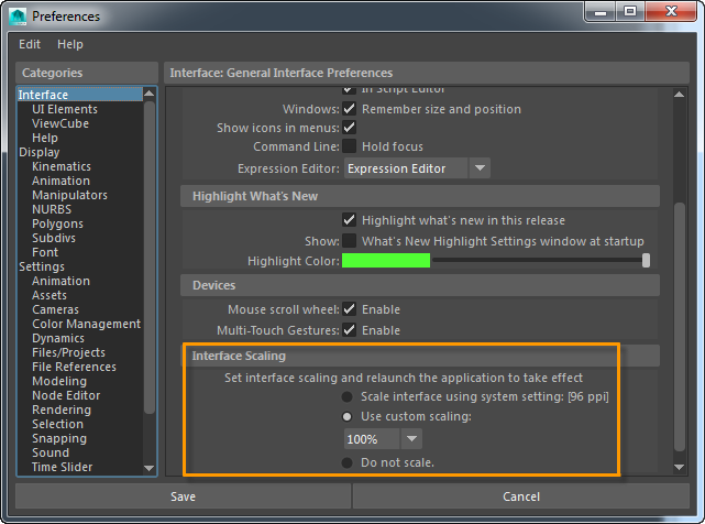

To change interface resolution
  1. Open the Preferences window (select Windows > Settings/Preferences > Preferences).
  2. Select the Interface preferences category, if it's not already selected.
  3. Adjust the settings in the Interface Scaling section.
