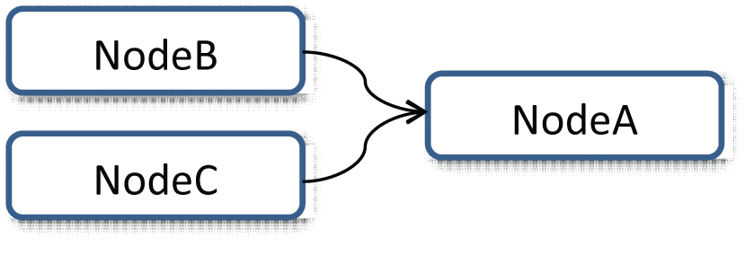

Parallel scene evaluation takes advantage of all available computational resources to evaluate scenes more quickly. This is done by building an evaluation graph from the scene description using the dirty propagation mechanism.
For the evaluation graph to generate correct results, dependencies must be accurately expressed in the DG. If node dependencies are incorrect for your scene, parallel evaluation will produce wrong results, or Maya may crash.
For example, in a scenario where NodeA depends on NodeB and NodeC, the evaluation manager must compute the state of NodeB and NodeC
prior to calculating the state of A.
A
Safe Mode performs sanity tests when parallel evaluation is activated. This Safe Mode prevents the most common types of errors from invalid dependencies. If the Safe Mode detects errors, the Evaluation Manager reverts to Serial evaluation mode, as indicated in the HUD. One reason Safe Mode may revert to serial evaluation is if a node instance is evaluated by multiple threads simultaneously.

Once activated, error detection occurs each time an evaluation is performed. Detected missing dependencies are then saved to a file in your machine's temporary folder. For example, on Windows, you would find results in %TEMP%\_MayaEvaluationGraphValidation.txt.
The following is an example report that shows missing dependencies between two nodes:
Detected missing dependencies on frame 56
NodeA.output <-x- NodeB
NodeA.output <-x- NodeC [cluster]
Detected missing dependencies on frame 57
The "<-x-" symbol indicates the direction of the dependency. The "[cluster]" term indicates that the node is inside of a cycle cluster, which means that any of nodes from the cycles could be responsible for attribute access outside of evaluation order
In the above example, NodeB accesses the "output" attribute of NodeA, which is incorrect. These types of dependency do not appear in the Evaluation graph and could cause a crash when running an evaluation in Parallel mode.
