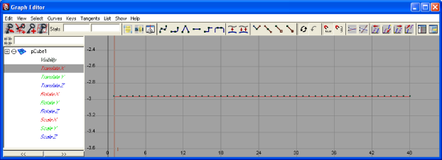

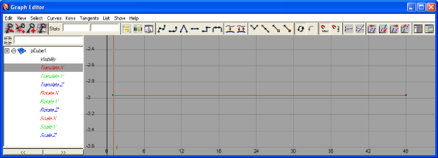

Constant Key Reducer
Activate the Constant Key Reducer filter to remove redundant keys. Redundant keys are keys that have the same value, which are equivalent to flat horizontal interpolations on a curve. Redundant keys are often a result of a resampled FCurve before filtering.
Before:
Resampled FCurve before filtering
After:
Filtered FCurve with redundant keys removed (based on Threshold setting)
You can set specific thresholds for each type of transform. Translation Precision, Rotation Precision, Scaling Precision, and Other. Other includes transforms like Blend Shapes and custom attribute curves.

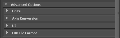

Advanced options
The Advanced Options section primarily contains additional options that let you modify the default plug-in behavior. In most cases, you do not need to modify these options to have a successful export. The section also holds additional settings specific to the Collada file type.
Units
The Units option lets you view the conversion factor (scaling value) the plug-in uses as well as modify the conversion units.

Use this menu to specify the units to which you want to convert your exported scene. Modifying this setting directly affects the Scale Factor value applied to the exported data.
The plug-in determines the default units by looking at the Maya System Units option in the Window > Settings/Preferences > Preferences > Settings category.
In the FBX UI, the displayed Scale Factor uses the FBX Unit setting for its calculation. The plug-in determines the FBX Unit setting from the host application system units.
On export, the plug-in applies no default scaling since the export and system units match. This results in a Scale factor of 1.0.
Note: Verify the system units your Maya scene uses so that you can control whether the plug-in needs to scale your scene. This way, it exports with the units you want. Maya lets you change the System Units without affecting the scale of your scene. Changing the system unit in Maya avoids scaling on export when not required.
For example, iIf you export a file that is in the same Unit setting as the System Units of your Maya scene, there is a match of units and the displayed Scale Factor is 1.0. No scale conversion is applied.
Axis conversion
The Maya FBX Exporter has two options for Axis Conversion in the UI. Y-up, or Z-up.
By default, the FBX Exporter always exports the Up Axis of the Host application. For Maya, this means that all scenes are exported with a Y-up world axis.
You can export your scene to a Z-up axis if the destination application does not support the Y-up world axis and cannot convert the Y-up world axis of your scene.
Note: The FBX Exporter applies Axis Conversions only to root elements of the outgoing scene. If you have animation on a root object that must be converted on export, these animation curves are resampled to apply the proper axis conversion. To avoid resampling of these animation curves, make sure to add a Root Node (dummy object) as a parent of the animated object in your scene, before you export to FBX.
UI
These options let you set display options of the UI. This lets you show or hide the Warning Manager and FBX UI windows. You can customize these display options, save them as a new Preset, and share this preset file. See the Creating a custom preset section for more information.
Show/Hide Warning Manager
This option lets you disable the Warnings and Errors dialog box that appears during the export process. The Warning Manager is active by default.
The Maya FBX plug-in uses errors and warnings to alert you of conversions and potential problems during the export process.
When something unexpected occurs during the conversion, the plug-in reports an error. This error occurs when the plug-in encounters an unknown behavior and the conversion is going to produce an unexpected result.
When the plug-in must apply a conversion to the source data for it to be in a format that the destination application can read, the Maya FBX plug-in reports a warning. This warning is not the indication of a problem, but instead exists to provide a report of conversions that the plug-in has applied to the incoming data.
Generate log data
Deactivate the Generate log data option if you do not want warning and error information written to the log. However, if you do deactivate this option, the FBX Exporter/Importer does not write log data (such as errors and warnings,) to the generated log file. However, the file name and time stamp are still recorded in the log.
The Maya FBX plug-in stores log files with the FBX presets, in C:\My Documents\Maya\FBX\Logs.
Occasionally, some batch imports/exports create very large warning/error files, and in this case you might want to disable this option. Normally, it is recommended to leave the Generate log data option active, which is the default, as this helps you identify problems with file conversions.
Log files are important for tracking errors and warnings on export. It is not recommended to deactivate this option when you export a series of files, for example, in an automation or batch export because you will not receive any feedback about any issues that concern files during export. This lack of feedback can make it difficult to identify problem files which, in turn, makes diagnosing problems difficult.
Tip: Because log data is appended to the same log file, after a while the size of this file become large. It is a good practice to delete the log file after a few exports, or before processing batch export or import.
FBX file format
This section lets you determine what form you want your FBX file to take.
Type
Save your FBX file as one of these two types, Binary or ASCII. While binary is the normal format for FBX files, ASCII files give you a plain text version of the file format, which lets you search the file for information retrieval.
Note: You cannot view ASCII FBX files in the FBX for QuickTime viewer. Instead, save your FBX file as a binary file.
Mode Function
Binary Activate this option to save the FBX file in the standard format.
ASCII Activate this option to save the FBX file in ASCII format.
Note:
If you export your file to ASCII format in FBX versions 2010 and earlier, you cannot embed media.
FBX version
Expand the FBX Version to specify an FBX version to use for export. This setting defaults to the latest version of the FBX plug-in installed.
Change this option only when you want to import your file using an older plug-in version; where the source plug-in version and destination plug-in version do not match. The following table lists the different versions available for you to select from the FBX exporter.
Version Description
FBX 2018 Select this FBX version to export a file that is compatible with Maya 2018, and Maya LT 2018. This is the default FBX version.
FBX 2016/2017 Select this FBX version to export a file that is compatible with Maya 2017, Maya LT 2017, Maya Ext 2, Maya LT Ext 3, Maya 2016, Maya 2016 Ext 1, Maya LT 2016 and Maya LT 2016 Ext 1 and Ext 2.
FBX 2014/2015 Select this FBX version to export a file that is compatible with Autodesk 2014 applications and 2014 FBX plug-ins.
FBX 2013 Select this FBX version to export a file that is compatible with Autodesk 2013 applications and 2013 FBX plug-ins.
FBX 2012 Select this FBX version to export a file that is compatible with Autodesk 2012 applications and 2012 FBX plug-ins.
FBX 2011 Select this FBX version to export a file that is compatible with Autodesk 2011 applications, 2011 FBX plug-ins.
FBX 2010 Select this FBX version to export a file that is compatible with Autodesk 2010 applications and 2010 FBX plug-ins.
FBX 2009 Select this FBX version to export a file that is compatible with Autodesk 2009 applications and 2009 FBX plug-ins.
FBX 2006 Select this FBX version to export a file that is compatible with Autodesk 2006 FBX plug-ins and MotionBuilder 7.5, 7.0, and 6.0..
Thumbnail/Playblast options
Lets you set up and capture a thumbnail (single image) or playblast (image sequence) to be saved with your scene file to identify it in the Content Browser. See Capture Thumbnail/Playblast options.
