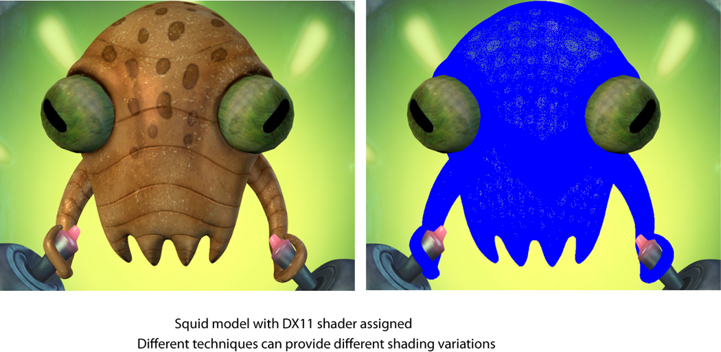

Technique
A single effect can specify one or more techniques to provide different shading variations. Maya exposes the available techniques in a drop-down list in the Attribute Editor.
