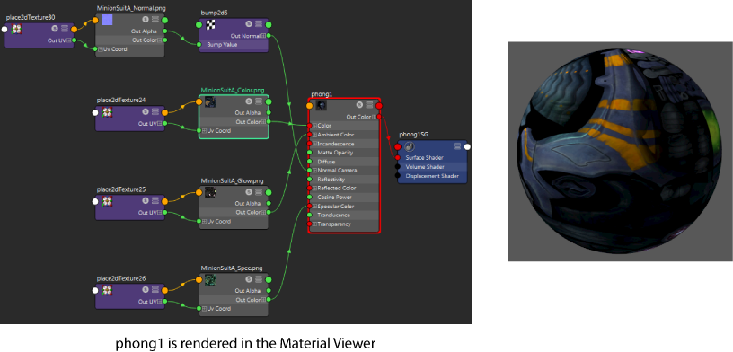

Render your shader network
In this example, you can select any node in the graph to see the downstream result of the network (phong1) in the Material Viewer. The node that is rendered in the Material Viewer is denoted by a red border.

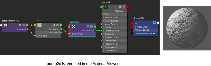

Render a bump map
You can render a bump map in the Material Viewer, and it appears as a 3d geometry swatch to allow you to better examine the bumps under the influence of lighting.
