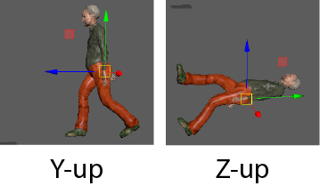

In animation and visual effects, the tradition is to use Y as the “up” or elevation axis, with X and Z as the “ground” axes. However, other industries traditionally use Z as the up axis and X and Y as the ground axes.
In Maya, you can switch the up-axis between Y and Z.
