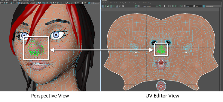

The UV Editor lets you view and interactively edit the UV texture coordinates for polygon, NURBS, and subdivision surfaces within a 2D view. You can access it from either Windows > Modeling Editors > UV Editor or the UV > UV Editor menu in the Modeling menu set. For more information on how UV shells are used, see the related topics below.
You can select, move, scale, and generally modify the UV topology for a surface very much like you work with other modeling tools within Maya. You can also view the image associated with the assigned texture map as a backdrop within the UV Editor and modify the UV layout to match as required.
You can easily compare a 3D object to its 2D texture coordinates by using the UV Editing Workspace. This workspace displays the perspective view and the UV Editor simultaneously, allowing you to see how UVs within the 3D scene view pertain to those in the UV Editor's 2D view and vice versa.

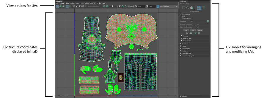

All major UV tasks are accessible within the UV Editor either via the UV Editor's menus, View bar, or UV Toolkit. Additionally, many functions are available outside the editor via the Modeling menu set's UV menu.
UV Editor menus
For a list of UV Editor menu items, see UV Editor Menu bar.
View bar
The View bar contains options for changing the display of the UV Shells in the UV Editor and occasionally the Viewport.

UV Toolkit
By default, the UV Toolkit appears on the right side of the UV Editor and contains all the tools you need to modify UV arrangements. For tools and commands with additional options, you can Shift + click the button to open the appropriate options window. You can also right-click certain options for alternate functions.
Selection masks ()
Limits selection to Vertices, Edges, Faces, UVs or UV Shells. Double-click any of the icons to select all components of that type loaded in the UV Editor. Right-click any of the icons to deselect all components of that type loaded in the UV Editor.
