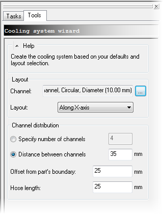

  1. Click (Geometry tab > Cooling System panel > Cooling Wizard).
  2. Ensure that the Channel diameter is 10 mm.
  3. Ensure that the Layout is Along X-axis.
  4. Select Distance between channels and specify a distance of 35 mm.
  5. Enter an Offset from part's boundary of 25 mm.
  6. Enter a Hose length of 25 mm.
  7. Click OK.
