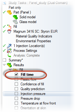

  1. Click Fill Time in the Study Tasks list.

  4. Click Injection Pressure in the Study Tasks list.
