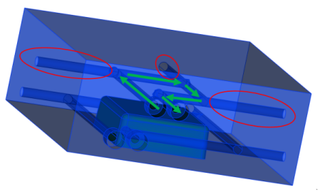

Stagnant areas
Cooling channels are usually manufactured by drilling holes from the outside of the mold, that intersect with other holes. The construction section of the channel is then plugged causing an area of stagnant coolant.
Models with stagnant areas need both an inlet and an outlet specified so that the program can determine the coolant flow path. Do not remove the construction channels from the model as the stagnant coolant in these areas heat up and impact on the heat of the system.
