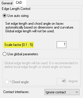

Auto sizing does not overwrite already defined local edge lengths and chord angles.
- In the
Layers pane, select the CAD body layers to mesh. Only the visible model layers are meshed.
- Click
- Click the
CAD tab and ensure that
Use auto sizing is selected
- Click
Mesh Now.
Note: You can adjust the edge length through a
Scale factor.
