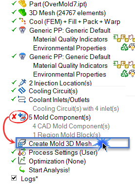

  3. Click (Mesh tab > Mesh panel > Mold Mesh).
    You can also double-click Create Mold 3D Mesh... in the study panel, if Mold component is not ticked (see Figure 2).
Figure 2: Create Mold 3D Mesh
The mesh parameters are automatically set, however you can customize them. The Global edge length is the main parameter to play with.
