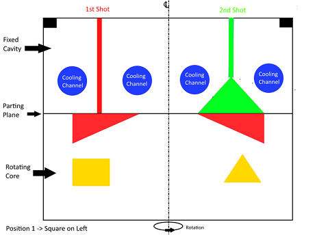

** ERROR 313460 ** No second-shot part mesh has been found. Ensure that the elements that comprise the second shot in the two-shot overmolding mold are present in the region where the second shot occurs and the rotation element box is not selected.
Explanation
This error is fatal. The solver could not find the mesh elements representing the second shot of your two-shot overmolding mold, as illustrated by the green component in the illustration.

  • Select the second component of the single cavity (green part, on the right side of the illustration).
  • Right-click the model in the Model pane and select Properties.
  • Select Part (3D) and click OK.
  • In the Overmolding Component tab, set the Component option to 2nd shot.
  • Deselect Rotation element, then click OK.
