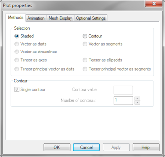

Default plot for Re-melt zone, part insert result
There is a new default plot for the Re-melt zone, part insert result which shows the actual remelt zone, where the part insert is above the transition temperature.
The Re-melt zone, part insert result from prior releases is a contour plot that shows the boundary between the remelt zone and the non-remelt zone. The contour plot, which is still available, shows the interface between the re-melt zone and the non-re-melt zone.
Previous Plot Properties dialog
Contour plot

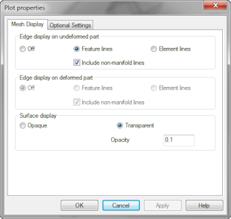

With this release, a shaded plot has been added, and is the new default. The shaded plot shows all the regions that are re-melted during the molding process.
New Plot Properties dialog:
Shaded plot
