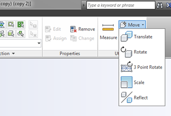

The modeling tools Rotate, Translate, 3 Point Rotate, Scale and Reflect are found on the Geometry tab and are used to manipulate selected entities, or the entire model, around a specific coordinate system.

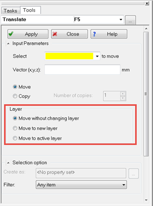

New options have been added to these tools, to provide you with more control over the layer organization of your model entities:
These options change from Move to Copy, depending on whether you have selected the Move or Copy option above.
