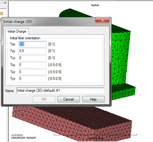

Fiber orientation enhancement in 3D compression molding
You can now specify all six components of the symmetric tensor in the initial charge for compression molding.
In prior releases, the three initial fiber orientation values that you entered for the initial charge were for the diagonal terms of the 2nd-order orientation tensor, assuming 0 for the off-diagonal terms. As such, (0.5, 0.5, 0) represented a random orientation in the XY plane. This implementation was to enable you to specify whether the initial orientation was 2D random (typically in SMC), or 3D random (typically in bulk molding compound).
With this release, you can specify the full tensor for the initial fiber orientation of the initial charge.
